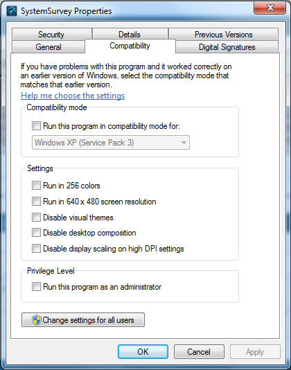

  6. Posts : 2
       #105
    Hello. I'm not entirely sure this is the correct topic for posting this kind of problem (please let me know if it isn't), but I have been experiencing a great number of compatibility-related issues with certain Windows (optional) updates. Previously, I have been installing regular recommended updates as normal. I began experiencing difficulties with a USB microphone. I checked the optional updates (they also included a graphics card update, and a realtek update) and installed them. Upon my computer starting up and me logging in, zero .exe files are able to be launched. After a bit of fiddling around and research, it appears all (.exe files at least) files have been set to run compatibility mode for Windows XP. I found that setting specific applications to compatability mode for Win7 let them run, but the problem remains for the hundreds of other programs switched to Windows XP Service pack 3. I have no idea why this happened, but the problem occurred after I installed a couple updates from 2011-2013. These affected the system files, and based on what I have read and see, I am not able to dig through update history and revert them or even see them.
    I tried the troubleshooting program, and when it produced its recommended settings, they were for Windows XP Service Pack 3 - so I am lead to believe that after the updates installed, they somehow decided it was a good idea that all my applications be switched to run compatibility mode for WinXPSP3.
    NOTE: Upon checking the file properties for .exe files, the "Run in compatability mode for:" box is NOT checked. In the dropdown menu right below (which is greyed out because the box is not checked), it says Windows XP Service Pack 3. Screenshot attached for above description. When this program and all programs I have not manually changed the compatibility settings for, it instantly crashes. I am willing to go into more detail with requested information, but I'm not very tech savvy, so in English please! :)
    I looked around a bit on these forums and it does not appear (at least at second glance) that anyone else had this problem occur to them. Any help or insight would be greatly appreciated.

  9. Posts : 73,289
    Thread Starter
       #108
    The .exe files are not actually set to use compatibility mode unless the Run this program in compatibility mode for box is checked, so it doesn't matter what is selected for compatibility mode until checked.
    I would recommend to do a system restore using a restore point dated before this started.
