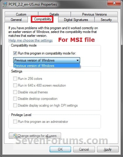

    To Set Compatibility Mode of Application in Properties Page
    1. Right click on the program's shortcut (LNK file), .EXE file, BAT file, CMD file, or MSI file.
    2. Click on Properties.
    3. Click on the Compatibility tab. (see screenshot below)
    NOTE: If the Compatiblity options are grayed out, then it is a 64 bit program and cannot be changed.

    MSI files (right screenshot below) will only have the Previous version of Windows option available for it. This option will allow Windows 7 to automatically use the previous version compatibility mode it thinks is best for the MSI file to run properly as. You will not be able to do steps 5 and 6 below.

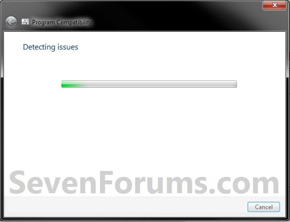

    Set Compatibility Mode of Application using "Troubleshoot compatibility"
    NOTE: This option opens the Program Compatibility Assistant wizard to let Windows 7 help decide what is best to try and make the program compatible.
    1. Right click on the program's shortcut (LNK file), .EXE file, BAT file, CMD file, or MSI file, and click on Troubleshoot compatibility. (see screenshot below)
    NOTE: You will not have the Troubleshoot compatibility option available for pinned items in the Start Menu or on the taskbar. You will only have the Troubleshoot compatibility option available for 3rd party programs in the Start Menu - All Programs area instead.
    2. You will see this for a moment while Windows 7 is detecting what the issues may be with the program. (see screenshot below)

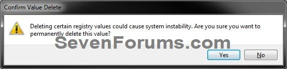

    5. To Stop a Program from Running in Compatibility Mode
    A) In the right pane of Layers, right click on the full path Name and click on Delete. (see screenshot below)
    B) Click on Yes to confirm deletion. (see screenshot below)

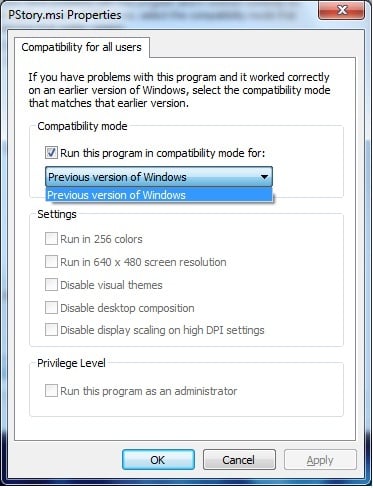

    I am using Windows 7 ultimate RC1. When I go to use compatibility mode to install Photostory 3 it does not give the same dropdown options shown in your tuorial windows. It only says "previous version of windows", and no other choice. And the program does not install.
    I also tried the wizard and it says something like "disabled version check". But it still doesn't install.
    I have found numerous sites and pictures on the web of people running photostory 3 on thier Windows 7 machines and installed it and run it using the steps above.
    How do I make the OS options show up for campatibility mode?
    Thanks, -Tim

    Are you sure that you are doing this to the installation/setup file?
    Could you post a screenshot of this? It may help determine what may be wrong.
    Shawn
  5. Posts : 3
    Windows 7 Ultimate
       #5
    Here is a pic of what I see when I select the installer.
    I was expecting to see the list of past windows OS's like in your tutorial. I have a hunch that this is trying to run in vista mode, which it won't work in either. But it runs fine on my other machine with XP on it.
  6. Posts : 72,247
    Thread Starter
       #6
    Tim,
    After some research on this, MSI files only have this option available. Instead of letting you choose what previos version of Windows to run the MSI file in compatibily mode as, it has Windows 7 automatically select what it thinks is best for it instead.
    It just doesn't seem like it is going to be compatible. You might see if there may be an update for it that addresses this.
