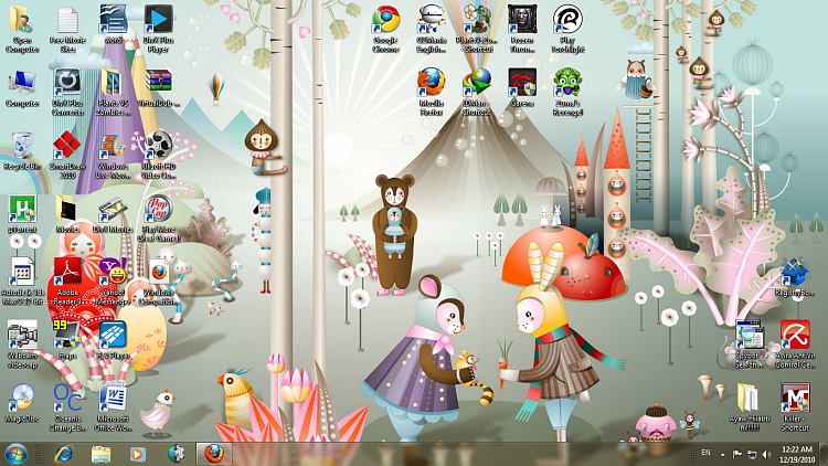

    It's fine now. I decided To Upgrade my W7 Starter TO W7 Ultimate.. And so the Problem is gone... Thank you for quick actions and response... Keep Sharing!
    Attached Thumbnails Attached Thumbnails Desktop Background Wallpaper - Change in Windows 7 Starter-s.png
