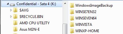

    I keep 3 or 4 image backups. They all copy to a directory of my C: Drive root name. All I do after the backup I go and add a date to the directory or a statement like "All updated and clean" That way the next time I do an image it will backup with erasing anything.
    Here is what my two backups are named.
    Now the next image will be written to "Iggy-PC "

    The browser is actually network locations in case you don't already have an image created. What Iggy did there was keep the images right on C while I went for broke on a totally separate drive where I tend to store files for other versions as well.
    You will first be prompted to back up your existing files before proceeding. Once Windows doesn't find the image at the original location I suspect that you will then see a prompt to browse for the image similar to what is seen with the Windows Easy Transfer tool.
