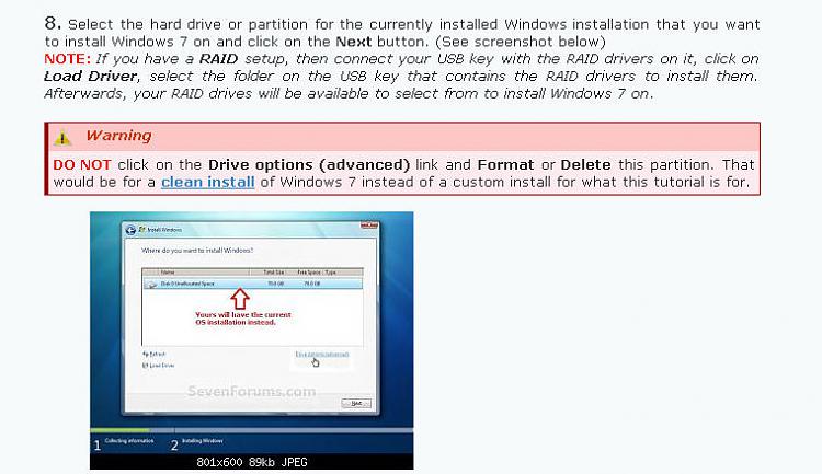

    Hey guys, when I get to this screen
    I donīt have any disk/partition/installation/item to choose.
    I asume this means I have to do a clean install, and lost all my info, am I right?
    EDIT - while attempting to do a clean install I find the same problem, it says there are no controller for any disk or device, and gives me the choice to load a controller, should I find my hard disk controller or driver?
    EDIT 2- there isnīt any driver to download . I have a wd15ears .
    please if someone can help me, at least tell me if there is any way to make it work, or my hard disk is lost for good.
    thanks to all

    Hey there, well just before you post this, I googled a bit and many people said it could be a problem with installation dvd, although it didnīt seem very credible, I tried burning a new dvd, and, who knows why, now the partitions appeared
    I have two of them,
    DISK 0 PARTITION 1: SYSTEM RESERVED 100 MB , 70 MB FREE, TYPE: SYSTEM
    DISK 0 PARITION 2 TOTAL SIZE 1397.2 GB FREE 1397.2 TYPE PRINCIPAL
    donīt want to mess things up, so I preffer to wait for your advice on what to do
    thanks,
