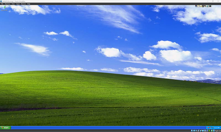

    I was at MDL to search a solution of XP activation on VB. finally got it.
    my VB test has been completed, with Office 97 SR2 installation. (I have a suite of XP SP3, Office97 SR2, all with CD-key. but never get a chance to test on a "modern" computer). my HP no CD/DVD-ROM. Dell does. hence this test has to run on Dell.
    For good performance, need to install VirtualBox Extension Pack (to take advantage of large screen and high resolution)
    1920 x 1086
    Full screen with Office 97 SR2 installation
