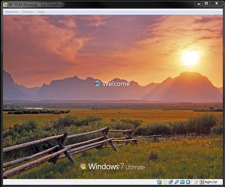

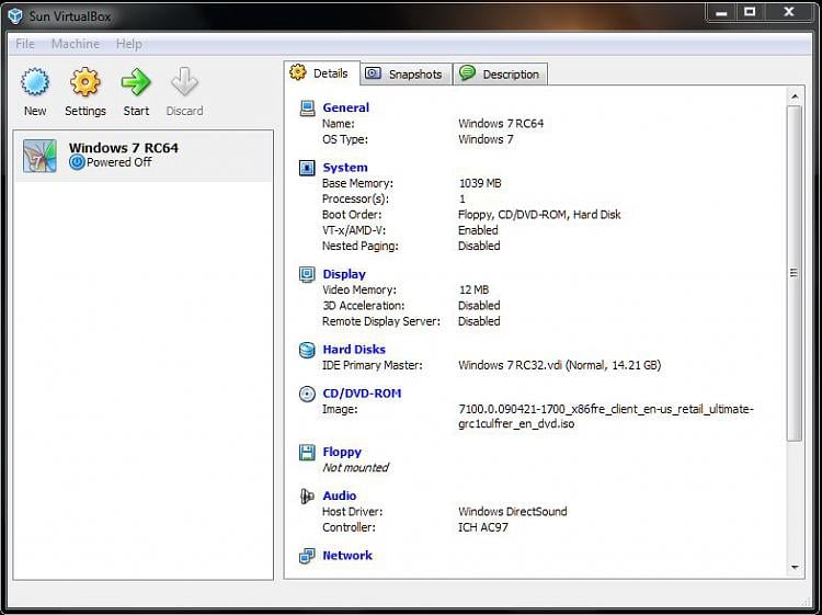

    I'm not the usual VB but the Portable VB on a usb flash drive to start with. I still haven't gotten around to installing the version you normally see go onto the main drive on this 7 install.
