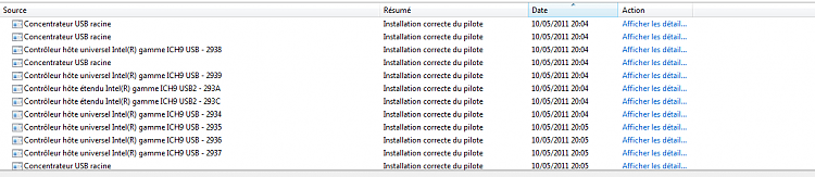

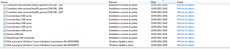

Those had been updated on mine without any issue...i'm on laptop and all have been correctly installed.
You can try to have a quick look after the install in the Reliability Index Score (RIS) and check for details on each USB devices updated.
Disabled USB after 5/11/2011 updates-capture.png   Disabled USB after 5/11/2011 updates-capture2.png

12 May 2011   #5
NoN
Here there's a complete list of the usb drivers versions updated: http://support.microsoft.com/kb/2529073/en-us
You can also go in the Devices Manager" in Control Panel checking which usb versions had been changed.
