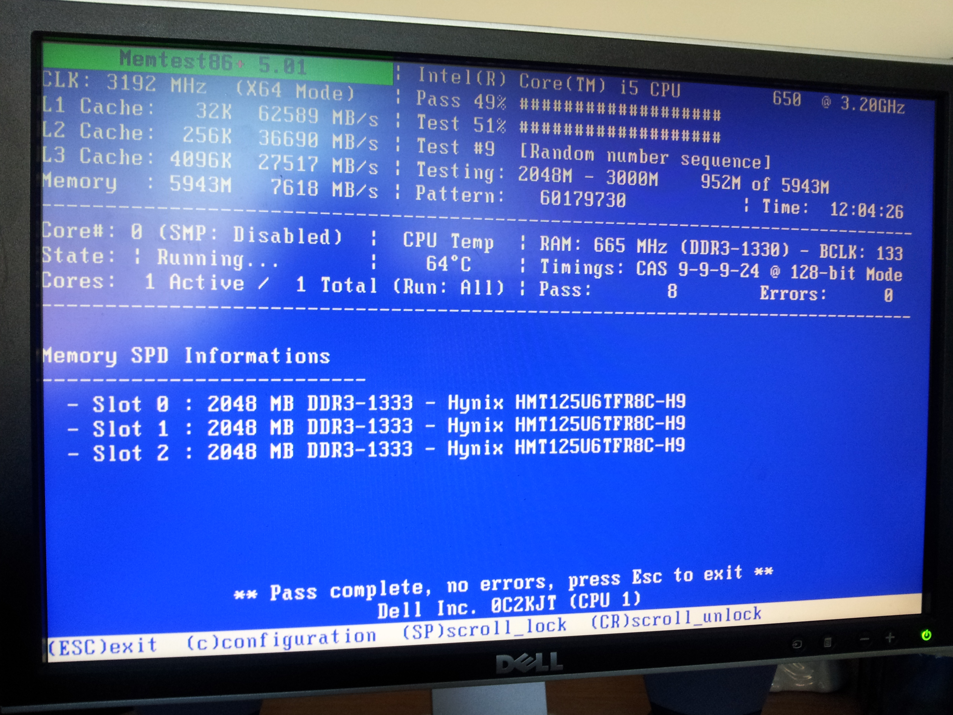

Thanks so much for all the info! I'm on pass #3, 3 hours in and no errors so far. My system is showing 3 2g sticks, but I haven't opened it up yet. It's night here so I'll see how it is in the morning. If it makes 8 passes without an error, do we have anything else left to try?

Sorry late reply mate but am at work about to leave for home and bed but in reply lets just see what the RAM test comes up first then we can go from there. Strange you should have 3x2GB and it is showing 5GB RAM though maybe just a glitch in the system.

OK, I ran the Memtest86+ all night for 12 hours...it made almost 8 full passes and didn't find ANY errors. Do I need to run it again or is that good enough?
Here is a shot of what it looked like.
http://www.mattthecat.com/RAMDiagnostic.jpg
I'll download the program you suggested and post the results.
I'm stumped now that the RAM test came back negative. What's going on here?
