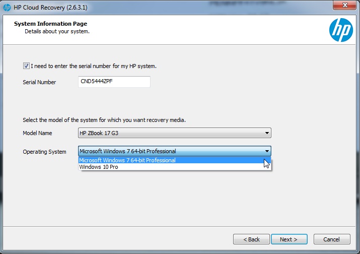

    I dont think they have win7 key hardcoded. Afaik there would be a msdm table for win8 and a slic table for win7. The win7 recovery/downgrade media should automatically activate offline.
    The op could d/l the media from hp using the cloud recovery tool , but it is massive if you want the drivers as well.
    http://hpsupport.cloudrecoverytool.d...coveryTool.exe
    or here HP Cloud Recovery Tool - Download
    Put in any serial number like the one below, then select what machine you want it for in the dropdown. If it is not still showing the exact machine then pick a more recent one with win7x64 pro download, should work fine.
    It d/l a big wim to the TEMP folder ( or two wims if you select drivers) then extracts them to usb stick.
