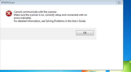

I installed the software into a virtual machine and I got a what I expected - this error:
Notice that your screenshot shows the little scanner icon to the left of the word EPSON - so I think that your window happens a bit further into the application launch. But I can now play with the error window that I have and show you how you might be able to move and re-size your window. Maybe there is some useful info in that window or maybe it will be blank. :-(
I changed the window that you see above into this...
...by using one line of AutoIt3 code.
Then I made it bigger than normal...
...with this line of code: WinMove("EPSON Scan", "", 0, 0, 600, 345)

THANK YOU!! That brought a tear to my eye. That one small window stayed, but the script popped up the window I needed, albeit at the size shown. I then clicked on the drop down menu upper right and it resized it correctly according to the option selected. I closed the application and reopened it, and the problem is gone (working like it is supposed to, without that other stuck window).
