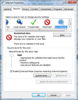

When investicating this I found that internet properties/ security has 5 Zones.
Internet, Local intranet,Trusted sites,Restricted And My computer.
however My computer has an odd icon with a key symbol, and shows nothing when I click on it.
My System Restores before the virus have been completly corrrupted, and I reallly don't want to have to reinstall everything so if any one could help me fix this damage, I would appreciate it.
