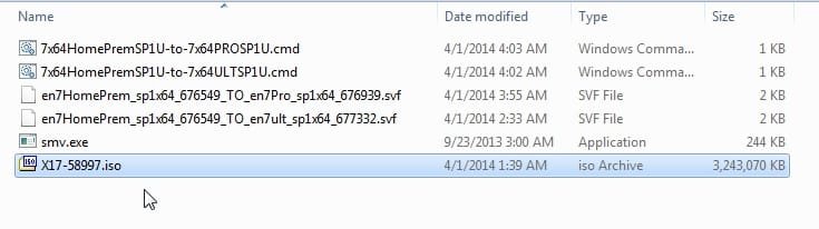

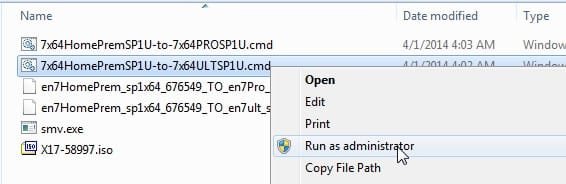

View attachment 7X64EDNS.zip
There you go.
It is very easy.
1. If you start with Home Premium X17-58997.iso obviously. use this folder:
2. You will see these files inside:
3. Copy your X17-58997.iso into the folder :
4. Then rt click and run as admin to create a new iso, either Pro or Ult. A command window will tell it is working, it takes about a minute.
