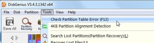

Might be a partition table error. You could run diskgenius and see if it finds a problem.
In the top pane click Tools , then from the menu check partition table

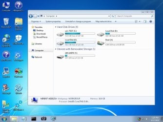

If you are using my boot media, it should look something like this with the letter Y assigned to the usb stick and X: as 0.99gb
