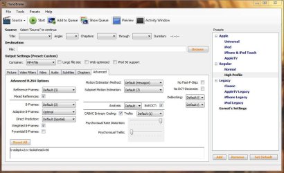

I'm unfamiliar with handbrake, and not sure what options it gives, but i believe its based on the x264 encoder, correct?
On top of what Sopolias Falst has suggested, I would also add:
Do NOT change the number of threads either. This will not speed anything up, and will do more harm than good. leave it on auto and let x264 choose the appropriate settings. It will adjust itself accordingly.
If your attempting to speed the encoding process, there's sadly only 2 choices:
1. Lower encoder settings, (or fast encode type settings) which result in poorer quality video but faster encode times.
2. A CPU with alot more power adept at crunching numbers quickly, such as a quad core
Better off IMO, set the encoder to the target quality you want, and wait it out.
To help spped things up however, a couple tips i have learned if it interests you:
M.E. Algorithm = Multi-Hex (I have found this setting to be just right. Anything higher, significantly increases encoding time with no noticeable gain)
Subpixel refinement = 7 ( setting of 9 will yield the most noticeable result, however will also slow the encoding process significantly. 7 is a good balance between speed and quality)
M.E. range (16 or 24) Anything higher increases encode times for little to no gain in quality
No fast Pskip = slows encode time slightly but not drastically, and worth the trade IMO. helps reduce gradients in some scenes such as sky

Yes, Handbrake is a GUI for using solely with an h264 encoder, mainly targeted for Apple users, but is very popular among Win users as well...
I already listed some advanced video options that Handbrake let's you tweak, but here's a screenshot of the tab with the High Profile loaded (which I don't use obviously :P)
