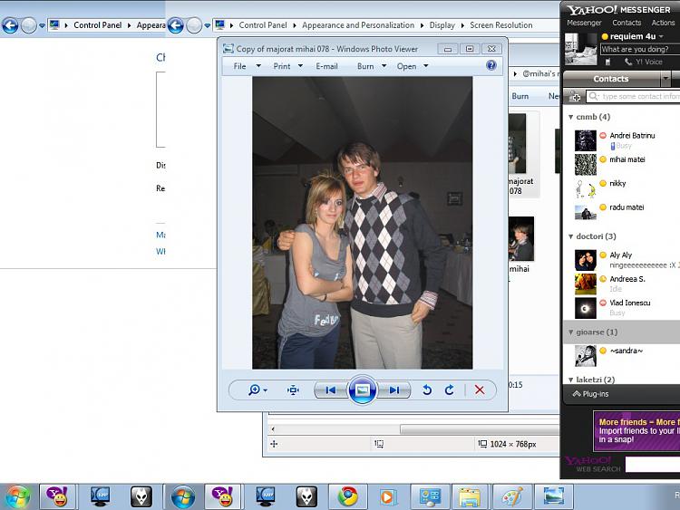

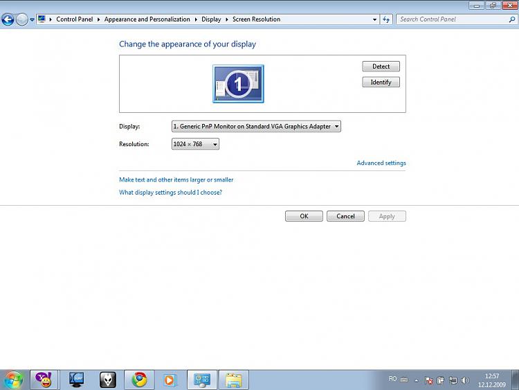

i'll send 2 screenshots.it won't be easy 4 you to realise it, but in reality i'm much thinner and taller than in the pic:))that sounded funny.i installed the graphic card driver from the ati site. i have an ati radeon x200..so theoreticaly there shouldn't be any problems.

How many inches is the display? Youre right, i dont see anything wrong with those photos. Take a look at them at another computer, and tell us, do YOU see a abnormality?

i don't see how my monitor's size could help, it's totally irrelevant, the aspect ratio is the problem.man, of course something's wrong otherwise i wouldn't be asking questions.not only the photos are wider, everything looks wider including internet sites, etcetera.even asking me to put some screenshots was an idiot idea because it implies me being stupid or paranoid about this thing.it's from the graphic card but i have no idea what exactly.would you please be kind and not put an answer to this thread unless you can say something that could sound even a bit logical.thank's alot

While your video driver is showing standard vga, you post this?
Install the latest video driver from the manufacturer instead.

If I read the specs on your notebook properly, it's native resolution is 1280X800. The images would definitely look stretched at 1024X768. Fujitsu appears to not support Win7 on it.
