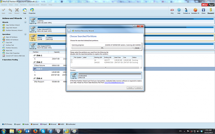

    The scan has been restarted (following the post you sent me step by step), here is a screenshot. So far it only detects 2TB for the entire disk. Should I let the scan go or can we expect that it will only detect the partitions on the 2TB it is working on ?

    OK, Seatools for Windows will only check your HDD if you had run only the Short test and long test.
    Unfortunately The Partition Recovery Wizard shows only 2TB. If you have the time, run a full scan. Let us see whether it finds 4TB. And yes, full scan will take a lot of time.
    If it does not find the missing 2TB, then perhaps you have to run PhotoRec.
    Unfortunately, I have no hands-on experience with GPT disks for I have no GPT disks for any experiments. So cannot say for certain whether PhotoRec also can scan full 4 TB. Anyway, we have to try.
