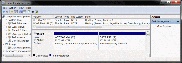

Format the HD first .. As an Active partition ..
and I don't think it'll ask you ... And it won't install the 100MB partition.
I went this way around .. don't have the 100MB partition .. and I'm working just fine.
After partitioning ...
