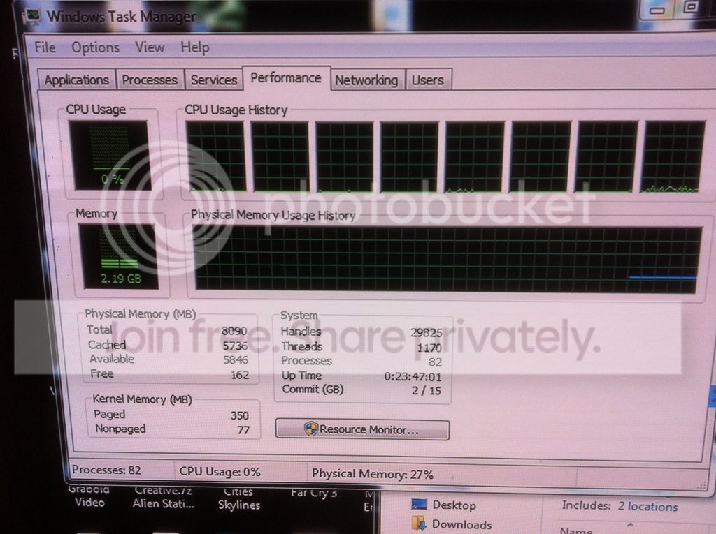

Under task-manager in Windows, its reading only 8g of RAM.

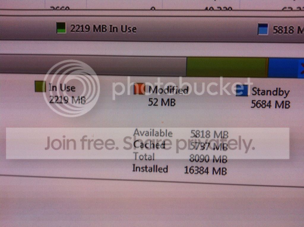

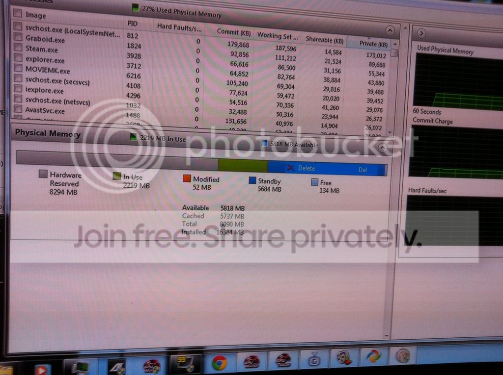

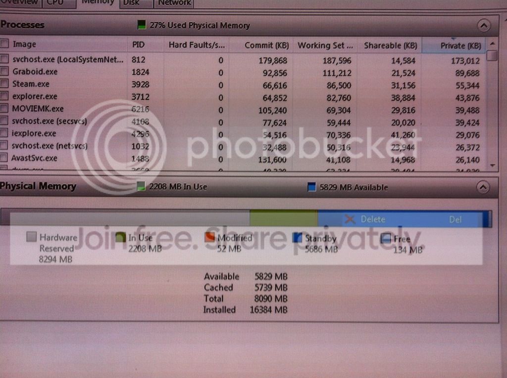

Under Performance Monitor in windows task-manager it reads............
Available.......5094bm
Cached.........4757mb
Total............8090mb
Installed......16384mb
So hows that for confusing !
The OS definitely see's this RAM, but just outright refuses to use it !

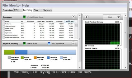

I would like to see this from your system.
Hi Layback Bear,
Pic's for you champ.

Every time I see hardware as high (8294MB) as yours the normal causes are:
1. Ram not installed correctly. Re-seat your ram.
2. Mismatched ram.
3. Ram settings not proper. Set ram to default in bios. Set your bios to default.
4. XMP going crazy.
5. The wrong ram installed for the motherboard.
6. People who have been messing with System Configure/Boot/Advance Options.
7. People trying to change video card ram usage.
Windows sees 16gb of ram and only uses 8 gigs because that is all Windows need to use with the load on the computer.
