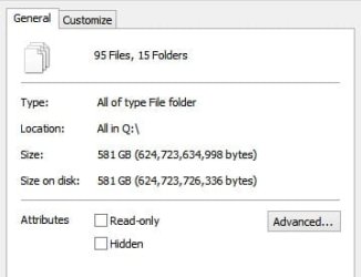

I have a 1TB external hard drive I use to store images of my computers. It is reporting that I have 56.8GB of 931GB available but there is only 581GB of data on the drive. I've emptied the recycle bin and removed any system files but it still will not show the free space I should have left. Could really use some ideas!

I'm actually using Macrium Reflect to make my images. They detail the space used accurately so I'm rather perplexed over the discrepancy.

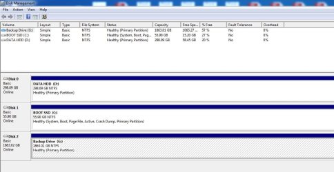

Check disk management with the drive plugged in and make sure has no properties it shouldn't ie not marked as active etc and the partition type is set correctly
Post a screenshot of this if you can
Heres a snip of mine with two internal drives and one external plugged (and yes I know my C & D drives are back to front im just to lazy to swap the sata plugs around :o )

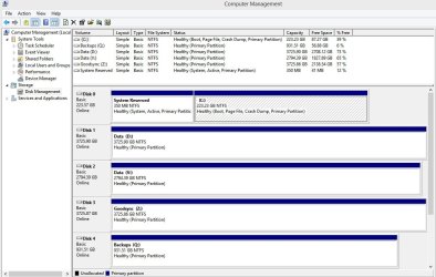

Attached is the screenshot as requested. It would seem all is OK.
Thanks so much for your efforts!

Running WinDirStat I found that the Recycle Bin for this drive was using about 300GB of space. I've never noticed an external drive to reflect the capacity WITH what is stored in the Recycle Bin. Just to be on the safe side, I will copy the data to another drive, re-format this external drive., and copy the data back again.
Thanks again for your assistance!
