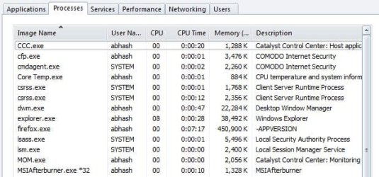

i have got 2 explorer.exe processes running on my system!!!
as far as i can remember it happened after i installed tune up utilities 2011 (but not sure about this)
can it be some kind of virus/malware??
am using MSE and comodo firewall
i have Unchecked “Launch folder windows in a separate process” option

thanks for the reply shawn
but this is the first time i am seeing 2 explorer.exes running at the same time on my system and also eating away twice the ram
and you are right the 2nd one closes after some time of closing the explorer window
is there a way to stop windows creating 2 processes??

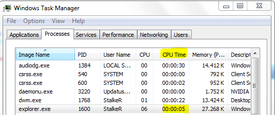

Hello there. This is what I'm doing when I see 2 explorer.exe processes. Open Task Manager and from View menu select Select Columns. There select CPU Time.
Now in Task Manager you'll see one thing more. That CPU Time show you how much time that process is active. So one explorer.exe is the original and it's starting with Windows(it have more time there) and another one should have less.
Highlighted is time that you need to know. This should help you with another processes,not just for explorer.exe

thanks for the tip :)
also now when i open diff. explorere windows i see only 1 explorer.exe process!!
