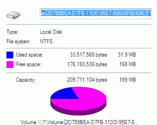

Hello all - new to 7 forums. I might have this post in the wrong place
With a default install of Win7, it creates a non-lettered 200Meg "system" partition with about 30 Meg of data.
I have been digging around for an explanation as to its purpose but found no clear explanation. Some say it's for bit locker, but then say that it would need to be at least 1 GIg. Some suggest that it's a way to guarantee an amount of free space for updates and backups (VSS needs a place to place snapshots). Some say it's the actual boot partition. Win7 starts the bootstrap here then moves the C: drive to load the rest of the OS.
If anybody has a clear explanation as to what it's for, I'd like to know.

It's the boot partition.

Hi Nick, and welcome to the Seven forums :party:
As smarty said it's the Boot partition but it's only created if you install to a completely fresh HDD if existing partitions are present then the install follows the form of earlier OS versions, and creates the boot file on an existing partition

Yes, it is normally hidden with no drive letter now. It was that way starting with 6936 I do believe.
If you look in Windows Disk Management you should see it listed as the System partition - this is MS speak for what everyone else calls the boot partition.
I believe it's a safety feature to keep it separate from the partitions your operating systems are on - what MS calls boot partitions.
Think the idea is if you hose any of your o/s partitions, you should still be able to boot up any other Windows o/s as the System partition is undamaged. You should also be able to make an image of it to restore in case of disaster.
Don't recommend trying a registry defrag if you have a separate System partition - you may get BCD issues.

I lettered the partition and was able to see the BCD, memtest, bootmgr, etc... It's definitely the boot...er:confused:....system...well:huh:...whatever it's called it is has the files that Windows needs to get itself up and going.
I do tech support for small businesses and if it it's not lettered most users won't ever even know it's there. It's the "power" users that will decide that it's not needed and try to mess with it. Fortunately, the only way to delete the partition is to remove the drive and do it from another system or boot to knoppix or erd, and kill it. Still, there is nothing to prevent someone from just deleting all the files in it.
I think this fits in with MS move towards componentization. It also might be a sign of MS moving even further towards virtualization. It seems conceivable that Hyper-V could be dropped into that partition and everything runs as a VM – albeit unknown to most users. Also, moving the bootstrap out of the core OS is required if you are going to boot to a VHD, which is one of the new Win7 features. It all makes sense now.

There will surely be folks who want to know if they can delete that partition to recover the space. Probably some that will just delete the space and then....
Gary
Good point Gary - I'm sure people will try.
I don't think it will allow you to do that - at least not if you are using Disk Management.
Anybody got one of those little System partitions and would like to try deleting it to see if it lets you? (Don't try this unless you're an advanced user):D
Yep - we get a few posting questions on the Vista Forum who want to empty/delete the oem "recovery" partition because they don't know what it is.;)

For many, it's not really about *how much* space it is, they tried to delete it and couldn't. They tried to format it and couldn't. That will just piss some off. "What do you mean I can't delete it, it's my &^$$#%# computer. Some, like myself, would say 'OK what am I not understanding here? I have one on my dell that I can't assign a driver letter to. 55MB. The space is nothing, but until I found out what is in there-the whats, whys, and wherefores- I was not satisfied.

Again, if they are not savvy enough to understand that the 200 MB space might be there for a reason, then they really have no business poking around the computer's innards.
I cannot count the number of times someone with less then techie skills has gone in and done something just as you are hypothesizing - that is what gets users into trouble in the first place,. Yes, it may be *your* computer, but give the developers of the OS *some* credit - that is there for a reason, why try to mess with it? Give your OEM some credit for setting up the system as they do - that extra partition at the end is there for a *reason* why try to mess with it?
In the grand scheme of things it would be a lot better if tools like Disk Management used pretty accurate representations, so that a 200 MB sized partition does not appear to be 1/2 the size of a 400 GB partition. Then again, there are always going to be those people who have only a little knowledge, but think it is their right to do anything they want to their systems.
