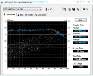

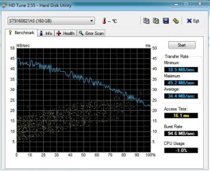

If you really want to know, download HD Tune and run the performance test. If the resulting curve starts out high on the outer part of the platter and gradually drops down as it approaches the inner platter, then you are being limited by your hard drive and not USB. If the curve is flat then you are being limited by USB. See Below with a cheap 2.5" drive in an external USB3.0 enclosure. The first is connected to a USB3.0 port and the second to a USB 2.0 port. You can see where the USB2.0 chops the transfer speed.
Also notice that my 2.5" HDD is going at full rate on the USB3.0, but it is only averaging 35 MB/s across the disk. The 2.5" drive is just that slow.
