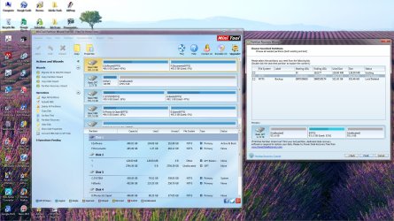

When I booted Win7 ran a CHKDSK on one of the partitions on the 3TB drive. When I got back into Windows drives G,J, and K had disappeared. DIsak Manager shows the drive as 27984.39GB Unallocated.
I found this forum and did some reading. I downloaded MiniTool Partition Wizard and it shows the following:
Please help

From the PW screenshot you posted I see that you seem to have lost your first partition. Partitiion Recovery Wizard did not find it. But it did find the second and third partition.
1. It is inconceivable that your HDD got corrupted just because you ran disk check. You ran checkdisk because you had a problem. What was it?
2. What prompted you or made you think that running checkdisk will resolve that problem?
3. Did checkdisk complete?
Though this is not going to resolve the issue, it will help us know the status of the disk at that time and whether running checkdisk on that problem had made it worse to the current situation.
I have my own doubts whether Partition Recovery Wizard is going to help in this case.
We haven't had any GPT disks on which we had run Partition Recovery Wizard. All the same we shall run it again but not before I examine some crucial sectors in the drive and backup those so that we can revert back should the condition of the disk become worse.
But that after you answer the queries above.
I would also like you to post a screenshot of Windows Disk Management. ( Please remove any USB drives from your PC. )

I don't think so but given that its going to be easy to plug out other secondary drives leaving only the system drive and the problem drive, do you think the OP should do it? You may instruct the OP so. It is a custom-built PC and so the OP should be able to do it easily.
