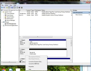

Thanks for the replies, but I'm not getting anywhere.
  • The drive is seen as a GPT drive. I've checked time and again with Disk Management, CMD, partition software, and all say it is a GPT drive of 561.40 GB in size. See attached JPG.
  • I've run the procedure in the GPT tutorial literally a dozen times.
  • What is Intel Matrix manage? When I google it, I find a download that won't run on my PC.
  • I'm NOT trying to set up a boot drive! I'm a photographer, take lots of pics, and have them scattered all over the place. I thought this would be the solution.
  • I've installed large drives on this and other systems - though not 5TB in size - with no problems.
  • Question: checking the BIOS, I see drives are set up as ACHI, with the other option being RAID. Is that the problem.

Your Disk Management screen print doesn't show all info.
Use this tutorial for how to properly post a maximized DM screen print with all fields re-sized so folks here can see everything:
http://www.sevenforums.com/tutorials/274797-disk-management-post-screen-capture-image.html
