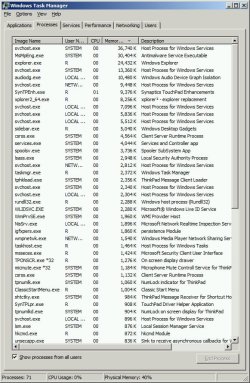

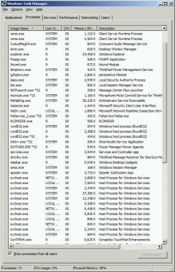

My computer has gotten molasses-slow over the past 6-12 months with no major new programs. Could it have something to do with the 71 processes that Task Manager reports when the computer is freshly started, with no programs opened? They use about 1 Gb of RAM - is that high? High or not, the computer is definitely very, very slow.
For example, is it okay to have 12 instances of svchost.exe?
I know you can look up processes online but it's not that simple. Can anyone recommend a preferred site for this? The problems is that sites tend to (1) report wide-ranging, contradictory opinions submitted by many users, and/or (2) provide useless non-definitions like "abcd.exe is a executable file for Windows. The filename extension .exe is the abbreviation for executable." A lot of the sites look like bogus aggregators or click farms.
Also, please be aware I am most of the way through this big list of steps for optimizing Win 7: http://www.sevenforums.com/tutorials/11728-optimize-windows-7-a.html
Attached: process list sorted by size and alphabetically.
PS - I am most of the way through this optimization list, but plan to do Black Viper's services tweaks after checking out the running processes.

12 Instances of svchost.exe is typical. How many processes you have running isn't very important. What is important is what they are doing, and considering that the displayed CPU usage is 0 the answer seems clear. Not very much.
40% CPU usage with a 32 bit OS and 2 GB RAM is very reasonable. I doubt your problem is memory related. But understand that 2 GB RAM is the minimum for a 32 bit OS. 4 GB will allow a higher working set for processes, more in the system cache, etc, leading to better performance.

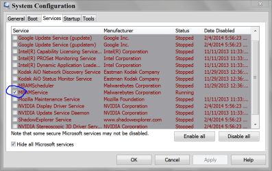

These pictures might help. Msconfig/Startup and Services.
Notice: Hide all Microsoft Services lower left corner.

I already have Malwarebytes - the free version which only scans when you tell it to (i.e. 'manually'). If I understand correctly only the paid version monitors continually and does automatic scheduled scans.
I read somewhere that the free version is adequate if you run it every week or two and also have MS Security Essentials, which I do.
