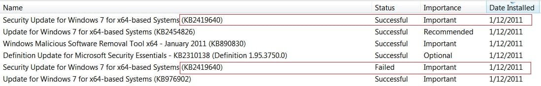

Hi! Everyone,
I'm not sure if I have a problem or not, and I need your valued opinions.
This morning I had five updates, four from patch Tuesday, and one MSE. for a total of 26.6MB.
I accepted all five, and told Win Update to go ahead and install them all. There were some that needed a restart and at the end of the update I was asked to restart my machine which I did.
Update came back and said that one failed (KB2419640) because of an 80080005 error. The troubleshooter offered suggestions on how to fix this, and one of them was to restart my machine which I did again, and it still came back that it failed.
I then went to KB2419640's download page, downloaded the file, proceeded to install it when it came back and said it wasn't going to because it was already installed....At that point I became :confused: .
I went back to Control Panel\All Control Panel Items\Windows Update\View update history, and this is what I saw. See attachment.
So...Do I have a problem or is it something not to worry about?

I think a lot of people are getting a failure on that update including myself. The solution for me was to allow the reboot before the failed update was attempted again. it went through cleanly on its own.

Control Panel> Windows Update> View Update History.
For those who don't know.
Then in the left picture below click circled in yellow Installed Updates.
Picture on right find the update and highlight. Then click "Uninstall" at top of list just to the left of "Organize."
Re download and install update.
Best would be direct from MS.
It should work with old one deleted.

Hi! Hoppy, great to hear from you again!
We had an advertising slogan at the newspaper where I retired from..."Now you know"!...
Your solution is a lot more elegant than what I went through. Thanks for the tip!

Hello!
Apologies for the late reply. I have been taking a mini break :) Anyway, I actually believe that this issue is now resolved. Your update history shows a success, and the standalone thinks it has been installed. I think this is all that really needs to be said. If you are not happy, tell me, and I will check the logs files (not WindowsUpdate.log!)
However, I may as well explain the error message while I am here.
We are looking for an error lookup from winerror.h. This one is easy, because it only derives from winerror.h:
C:\Users\Richard>err 80080005
# for hex 0x80080005 / decimal -2146959355 :
  CO_E_SERVER_EXEC_FAILURE                                      winerror.h
# Server execution failed
# 1 matches found for "80080005"
C:\Users\Richard>
This error code is usually caused by stress, and therefore sporadic. There must have been something in this update which stressed COM. You can read more about this error here: When CoCreateInstance returns 0x80080005 (CO_E_SERVER_EXEC_FAILURE) - Antimail - Site Home - MSDN Blogs
I don't think that it is worth trying such an invasive solution for something which I believe is already installed. However, let me explain what it does. All it really does is set the Desktop heap. On a computer such as yours, it will likely limit the heap. This is not necessarily a bad thing. I would imagine that this is already in place on your computer anyway. Desktop heap is stored next to page file for a good reason, they are quite similar. You can read more about this whole key here: Windows and the ClearCase process limit: Understanding the desktop heap
If you want me to see how installed it actually is, copy C:\Windows\Logs\CBS\CBS.log to your Desktop, right click on it > Send to > Compressed (zipped) folder, and upload that zip file here.
I hope I have managed to contribute something, even in my lateness!
