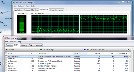

Since I have all SATA HDDs now, I recently switched to AHCI. Following this I started to get a lot of keyboard lag in some programs. This seemed to be linked to the Microsoft AHCI drivers, so I updated to the latest from AMD.
Now the keyboard lag is gone, but one of my cpu cores is always running near maximum, which means slowdown in some other programs. Any ideas?

I d/l Latency Monitor (free from Resplendence) at it points to storport.sys - seems to be a Microsoft driver for RAID? Except I'm not RAIDing.

Thanks Matts; however before updating to AHCI and the latest chipset drivers the system was running just fine with 4GB. Second, not sure why a RAM deficiency would cause a single core to run at full throttle at idle (with only a browser and Task Manager open).

Hmm - this seems to be a moving target. On reboot the drivers with the highest interrupts is now dxgkrnl.sys which is the DirectX driver. Gah!

I went through the routine in the tutorial a couple of weeks ago.
Device Manager does not indicate anything there is amiss (all the HDDs are detected and appear to be running in SATA mode. Boot is normal - SATA drives detected as they appear in the BIOS, and all the drives function normally.
I updated drivers (through ATI Catalyst) because the mobo uses an AMD southbridge chipset.

I see you tried those drivers initially, but reverting the drivers worked for me.
Spent an hour trying to figure this out earlier today, after installing the Catalyst Omega chipset drivers on my 760G mobo + FX6300.
Problem went away when I reverted to Microsoft's AHCI drivers. Back to ~0.1% interrupts periodically instead of ~11% constantly.

Sigh. I had to rollback too. But it did fix that problem.
