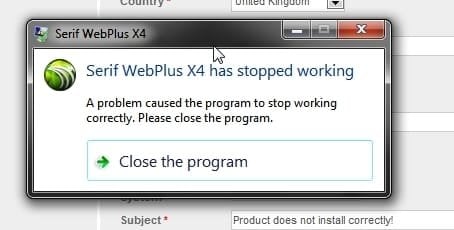

This problem exists with only a handful of programs, the main one being Serif applications and in my case Serif Webplus X4 which is a cerified Windows 7 compatible program. For example; On successful installation I try to launch the program and the following box appears saying: Serif WebPlus X4 has stopped working. A problem caused the program to stop working correctly. Please close the program.
My system was upgraded from Vista Ultimate 32 bit to Windows 7 Ultimate.
