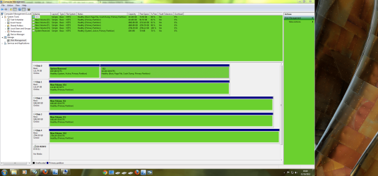

You can also post back a screenshot of the maximized DIsk Mgmt drive map and listings, using SNipping tool in Start Menu, so we can take a peek.

None of the drives have boot sectors - all just data no OS. Uploaded disk management snap...
