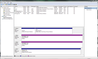

Just make it as big as it will go and try to keep 20% free space on it while in windows. What program are you cloning it with, it should end up like how my disk 0 is with full space after the boot partition used for the OS (it shows that one as 64% free atm).
