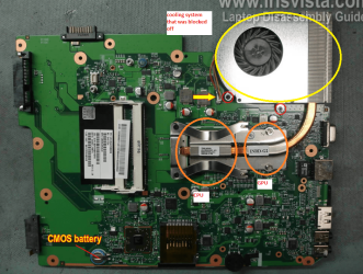

Hello and welcome Zena now for starters as you know resting the laptop on a pillow was about daftest thing you could have done as you blocked any air entry into the machine. Now it could be that you have cooked the motherboard as the GPU is served by the same heatpipes that run from the CPU too.
Now worst case scenario is the GPU chip is fried and the CPU too. What model Toshiba have you got??
Just to give you a rough idea of what is inside I have snipped a couple of pics from site I use. What you can do about well I suppose let the thing cool completely first the try again but I wouldn't be holding my breath:(

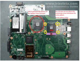

Well Zena the GPU that is fried (in my opinion) is actually fixed to the board unlike the CPU which you can take out and replace. So I am sorry but it looks like new motheboard or a new macine

Sorry Zena as I think I mentioned earlier the GPU is fixed into the motherboard the CPU you can swap out as it is retained only by that plate in the pic I sent but here it is again only maybe a bit clearer.
