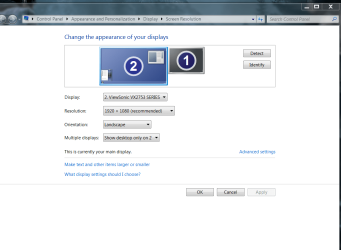

When you are on desktop right click and hit screen resolution
change to the 32 inch monitor it should give you options to extend or use the 32 inch as default should look something like this
After you do this go into your ccc and go to the flatpanel tv part and scale to size thats it

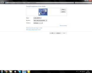

I only have one screen plugged in at a time as the graphics card has only one VGA port. So when i switch the VGA cable form the 19 to the 32 while the PC is still on, it will still say it is the 19" in the resolution settings screen.

attachment.php
This is what i have got when the i switch the VGA cable from the 19" to the 32" While the PC is still turned on.
