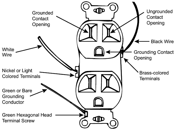

*Sigh* sorry but this is another one of my electrical issue topics...but I think it could be serious, moreso than my other one. :cry:
I recently (like two weeks ago) removed an old duplex receptacle outlet from one of my walls. I shut it off of course while removing it and I'm pretty sure at an earlier point I was fiddling with it while the power was on and thank God nothing happened to me then...by the way, I removed it because I was curious as to how they are hooked up and how I could replace them.
So anyway it has been removed now for about two weeks, and for that span of time (two weeks) the black and white wires, as well as the ground wire have not been connected to anything...meaning they're just floating there right now, unconnected to any outlet.
I'm not really sure if this is safe...especially when power is running to that outlet. You may be wondering why I just don't turn off the power to that outlet via my switchbox/powerbox. Well the reason is, when I do that, for some reason my internet goes down since I think it turns off the main source box that gives me my FIOS internet, and, although I can live without that for a while until an electrician comes and installs my new outlet, I have two brothers who are not willing to go even one day without internet.
Obviously it is not safe in the sense that someone could put their hand in there and get shocked, however I have sealed that area off with a paper towel with "KEEP AWAY" written on it, and I'm not quite sure whether or not the cable ends are touching that paper towel from behind...but I don't even want to make sure since it'll involve touching that area and I don't know what may happen to me...but so far it didn't make a spark or fire or anything so I suppose it's not causing any reaction with the paper towel...
So, I was wondering if this at all may affect any of the other electrical wiring in my house. Meaning, could it have an effect on neighboring outlets or any of the other outlets in my house (the fact I have one old outlet removed and the wires for it are just floating where they are, unattached to anything)? Because I noticed two outlets in my house that are not really working...one seemed to go from working to not-working sometimes, but 90% of the time it doesn't work, and the other one just plain doesn't work at all...the one that doesn't work at all is an outlet close to the area where the old outlet has been removed, and the outlet that doesn't work 90% of the time is in a whole different floor on my house.
My #1 concern now is if, the fact I have one removed outlet with the wires for it floating around unnattached is going to affect other outlets in the house (I'm really only concerned about the outlets in my room), and as I said it seems to have affected two outlets (I know I have everything turned on in my switchbox/powerbox so I know this isn't an issue) but has not really affected any of my room outlets...but I am afraid of plugging any more things in my room, since I have no idea what this may cause considering there's one outlet area in my house with floating unnattached wires...

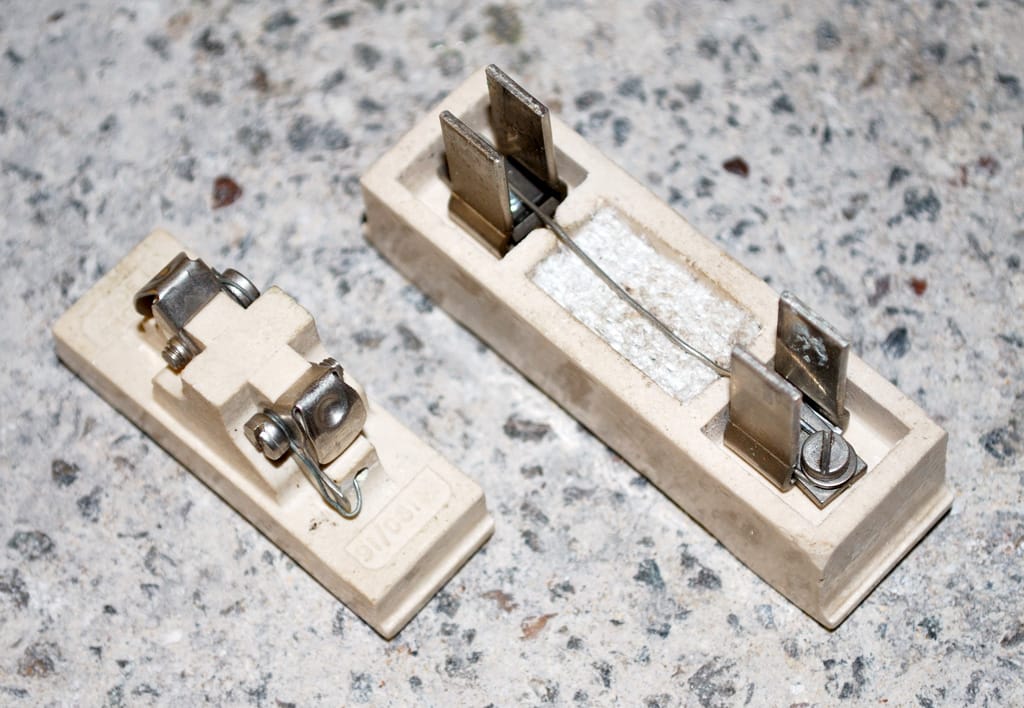

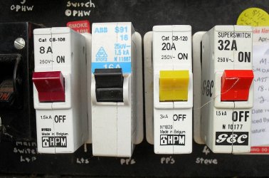

By the way, what is the difference between trip, and blow? Breaker and fuse? Not saying this will happen or it happened, but if one black wire has touched a white wire will there be a way for me to determine if this happened?
You trip a breaker, and blow a fuse.
A breaker is bascially the same as a fuse, except it is in the form of a type of switch.
You will hear it click when you short circuit the wires and it trips.
It is more expensive and safer than a fuse, as you can just flick the switch and you'll have power back.
Note, if you flick the switch back on and it flicks off straight away, you still have a short circuit in your wires somewhere.
A fuse, is No.8 wire generally wrapped around two metal poles encased in a ceramic block. You should hear it go bang when you short circuit your wires. If I remember correctly, No.8 wire is 10Amps... so should only be wrapped around the poles once. Twice would make the fuse 20A. Dont do this. It will make a bigger bang, and probably shock you if you replace it while there is still a short circuit.
Either way, you'll most certainly know if its been tripped/blown: You'd have no power on that circuit.

Thanks...I liked this quote...also don't you mean breaker, since a person either has a breaker or a fuse right? A fuse would be like a wire like you said, and a breaker is in a form of switch. So if I have something like this, the main board in my townhouse:
I have breakers (switches I think) and not fuses? Sorry if I have not gotten it yet. :(
^ok wtf @ the second image I did not even post that...lol...that just appeared after I made the edit...somehow...
Vista
yea those look like breakers.
Lol, That second pic is actually one of the famous 'fails' long before the whole fail trend started. I remember seeing it when I was in highschool.... (many many maaaaany years ago)

So xarden, a household either has breakers or fuses right? Meaning if they have a panel like that, they only have breakers and not fuses? Since I didn't think you could have both for your house.
Reason I'm asking is, I think you meant if the two wires have touched, it would mess up the breaker, not the fuse since I don't think I have fuses.
Vista
Essentially, yes. Older houses are likely to have fuses, as that was what was common back in those days.
Newer houses are likely to have breakers, as they are safer for the common person to reset.
As you can probably see, that example has main switch, lights, power points, power points, stove.
It wouldnt 'mess up' the breaker, it would just flick the switch and cut off power on that circuit. Its like turning the lights off at the wall, but does it automatically when theres a short circuit (wires touching) You reset it, or turn it back on, by flicking the switch. If theres still a short circuit, it will flick back off.
You can also buy from hardware or electical stores (@fastboy42: Mitre10) a fuse/breaker replacement. Its a breaker module that replaces the fuse block in old houses. They look like the ones in the 2nd pic.
(Both pics are sourced from Wikipedia)
