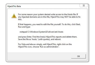

Hijack this:
as a attachment
after analyse this i've got the screen:
