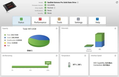

Thanks for your reply. My C Drive is a Sandisk SSD so I installed the Sandisk dashboard utility to test the drive. Everything seems to be ok. The temperature is a little high but I think that's because of the current heatwave. Here are the results of the scan:
