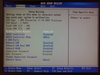

Stormy,
When i accessed the BIOS (F10) the Onboard graphics was set to PCI, which i do not have installed. I changed it to Onboard graphics and still nothing. I couldn't see anything else about graphics or a chipset.. Do you have any other suggestions?

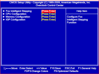

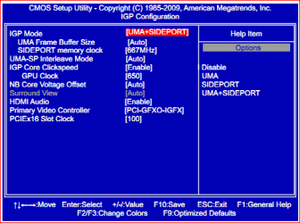

Wrong section and setting unfortunately. I had a look at the manual for a similarly spec'ed Foxconn motherboard, and if HP used a similar bios with various features/settings b locked as they are known to do then there is a very good chance that there is no way to adjust that setting. From the manual I looked at the onboard graphics settings are under a section called "Overclock Control Center",
with the actual settings in the "IGP Configuration" section,

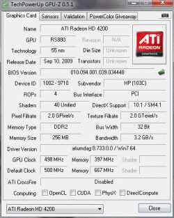

Let's come at it from another direction and at least see how much memory has been allocated to the onboard graphics. Grab this,
GPU-Z Video card GPU Information Utility
and post a screen shot of it please.

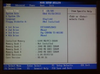

The link you sent didn't work. Here's what i took from the screen i was in...

As for those bios pictures, I'll not say what I think of HP intentionally crippling what the chipset is capable of by hiding those features/settings from users. It is one thing to hide the settings for overclocking but they are also removing useful features from it as well like this,
ATI Hybrid Graphics - Wikipedia, the free encyclopedia
That allows for using the onboard video with any AMD video card to allow using up to 4 monitors (or more depending on which of the HD 5xxx or 6xxx series of cards are used).

Ok Stormy,
This is what it shows. I don't know if this will tell you how i can access it or if i need to get a PCI card..

At least they set it to a reasonable minimum. Also looking here,
Adobe Forums: Search
it doesn't look like it is your graphics that is the problem, but something else.
