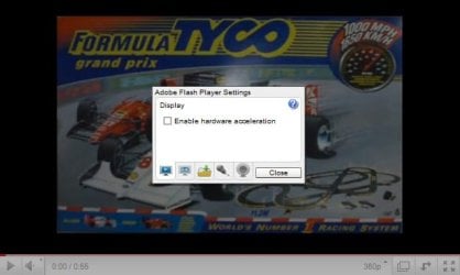

Turn off Hardware Acceleration in Flash and let us know if that works. worked for me.

Ok so tried it and it immediately flickered again
Windows 7 Home premium 64bit.
Easy way is to go to a youtube video and right click on the window and click on Settings.
On the bottom tab of the settings window click the tab to the far left and that should have a box and this next to it "Enable Hardware Acceleration". Uncheck the box.

did you shut down your browser and restart it?
I just turned it on on mine and it started to flicker all the screens again when I play a flash video and when I close that tab.
Unchecking it fixes it for me.

OK fixed it at first look, we will see how it goes on from now, what does "hardware acceleration" exactly do?
In this instance it would be disabling the ati stream feature.
