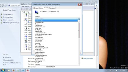

You might be able to find the info you want in the device manager\display adapter\properties\details (tab)

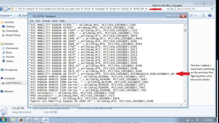

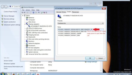

Thats exactly what I just did OEM, it seemed to work.
I found my device ID and manually put it into the .inf on the regular 9.6 catalyst drivers (not the mobility drivers). I first tried to do it on the drivers named '9-6_beta_win7_64_dd_CC' but when I tried to install them, they said 'These drivers are incompatible for this version of windows' or something.
So I went to the other set of drivers I downloaded named '9-6_vista64_win7_64_dd_ccc_wdm_enu', which had two versions named 'C7_81756' and 'CH_81756'. I modified both, but the one labeled C7 had the same windows incompatibility error. BUT for some reason, the CH one ran like a charm.
The line I put in was :
"ATI Mobility Radeon HD 4570" = ati2mtag_M76, PCI\VEN_1002&DEV_9553&REV_00
Those Dev/Rev were gotten from the device manager. I just used the at2mtag_M76 since it was the one used by the previous device (mobile radeon hd 3870). It seems to work so idk if it really is the right version or not.
SO drivers installed fine finally, but CCC Still won't install. I click setup, then custom, then it does its Analyze stuff and lists to install : CIM/HDMI Audio/MSEE Encoder or w/e. Doesn't list CCC/Hydravision/Anything else.

Sure, here are the screens.
The basic problem is Dell's drivers are 'proprietary' and do not support Windows 7. And dell makes ATI not offer driver support, so the devID's are not listed as compatible. Mobility modder basically just does what I did, put in the dev ID's into the .inf's. What I'm not sure of, does mobility modder also change the msi's somehow to make them compatible? Yeah, drivers now install fine and I can select proper resolutions finally. But when I connect to my TV, it still looks bad, needs some changes in the catalyst suite. Which won't install no matter what I do.
