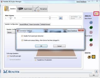

Hi XeRo,
Open the Realtek HD Audio Manager and left click the folder icon (shown within the red box). In the dialogue panel that appears, Connector Settings, ensure that both options are selected and then click OK.
Right click the appropriate socket and select Connector Retasking... (alternatively, double left click). This brings up the following panel. This is from my front green socket. Select the required option and click OK.
You can now close the Realtek HD Audio Manager by clicking OK.

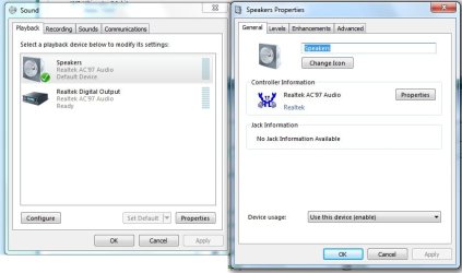

When I go to the control panel and click on "sound", this window appears (see attachment)

As I said before, check out Brink's thread, and download and install it.

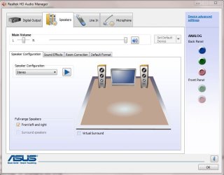

hi everyone i have problem here hope someone can tel me a solution.i am using asus p5kpl-am/ps motherboard and iam using on board sound card that is realtek alc662 6-channel high definition audio codec.so, whats the problem i am having is i am not able to use my front panel audio jacks(both headphone and mic).all the wire connections are given correctly from the motherboard to the cabinet audio jacks.no detection is been occurring in the front side when the pins are plugged.here i have attached the audio manager snap.please help me.thank you

Hi Harry,
If you click on Device advanced settings, does it bring up a dialogue like the one below? If so, ensure that the settings are as shown.
