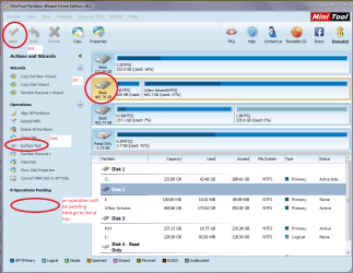

I am guessing here masta but maybe that is because if you installed it on one laptop the others may not be reading it correctly.
Now I suppose if it comes to it get the drive onto the PC where it does work and run a hard drive test on it from the PC the one usually used is Seatools SeaTools for Windows | Seagate
and one that does a surface (physical) test using Partition Wizard Best Free Partition Manager Freeware and free partition magic for Windows 7, Windows 8, Windows Vista and Windows XP 32 bit & 64 bit. MiniTool Free Partition Manager Software Home Edition. see pic

Ok it took a while and it seems it is full of errors, it failed its short scan and I didnt even bother to finish the surface scan. I think I will close this thread I feel I understand the problems and the beeping seems to indicate the head is stuck on the platter, I will try to fix that one.
Thank for the help I really like MiniTool, it is so fast for partitions and formats, as well as for the surface scan.
