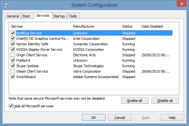

Ran that command in your quote, however I don't know what it does/if it will resolve this issue. :confused: Here are the non-Microsoft services I run.
I don't think these are causing the issue. I haven't tried cleaning the graphics drivers yet, however.
