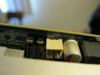

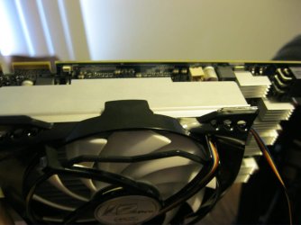

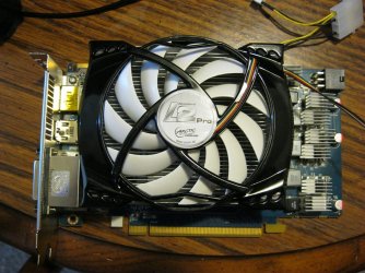

Here are the photos.

Hey nice, clear pics! You may be able to use the tip of a sharp knife to slip the wires out of the connectors and swap them. Just be sure to get the wire colors in the same position..
Likely you only need the red and black to run the fan, yellow being the RPM sensor.
EDIT: Here's a couple of pics to help. Those tangs are delicate but can be swapped around, I've done a few myself with fans and front panel connectors.

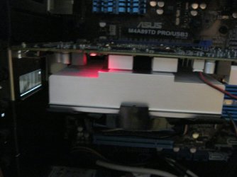

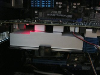

Plugged fan directly into card this time. Light is still red. Nothing's happening. The red light is still in the same place it was before, on the actual card. POST beep and everything, and the fan is running, but nothing else.
Here's some pictures of where the light is showing up. I don't know what else to attribute this to.
And this is the cooler on Newegg: http://www.newegg.com/Product/Product.aspx?Item=N82E16835186041&Tpk=arctic%20cooling%20accelero%20l2%20pro
And the fan IS running, so I know it's plugged in and everything. I put the right color pins in the right spots.
