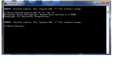

yousafali,
You just made a small mistake in the command. For your drive letters, you should use this command below instead. The F at the end of the command needs to remain an F. Only the red letters in the tutorial are to be substituted with the drive letters. :)
repair-bde H: G: -pw -F
The same result with
Bitlocker Drive Encryption: Repair Tool version 6.1.7600
Copy Right<C> Microsoft Corporation.
Invalid Syntax Error. Use "repair-bde -?" for correct usage
HP

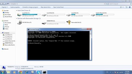

In that case, post a screenshot showing the full layout of your G: drive to see if it is able to be used to save the contents of the H: drive locked by BitLocker to.
HP
G: is system drive, and you will not be able to use G to copy the decrypted contents of H to. Plus, I doubt that G: would be large enough to hold H: even if you were able to.
You'll need to use another drive like E: or another external hard drive instead. Be warned that whatever you use will be wiped out in the process when saving the decrypted files from H: to it.

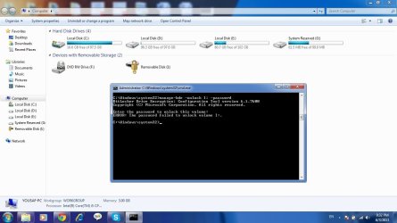

Here "I" is is my encrypted disk and "H" is the disk to copy decrypted data.
HP
Here is the result, i am the administrator.
HP
Try again in an "elevated" command prompt (click on link) instead. ;)
Just opening a command prompt while logged in as an administrator doesn't make it an elevated command prompt. You'll need to do what's in the link above to right click "Run as administrator" to do so instead.
What does it mean.
the password i entered was correct.
HP
You might try again in case you may have made a mistake entering the password. The password is case sensitive.
I do not think i forgot my password if so happened then ?
Is there any other solution?
HP
Since you do not have a backup of the recovery key or startup key for the USB encrypted by BitLocker to use to recover it, then you may be pretty much out of luck.
