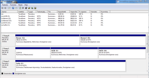

This is the screen. Of course its in finnish so I hope you find the info you need from there.
Disk 1 being old boot disk and disk 0 being just storage.

You'll need to mark G and F Inactive and C Active using Diskpart: Partition - Mark as Active (Method Two)
Then unplug DISK0 and swap its cable to Win7 HD, setting it first HD to boot in BIOS Setup, after DVD/CD drives. Physically unplug Disk 1 as well.
Now boot the Win7 DVD REpair console or Repair CD to Startup Repair - Run 3 Separate Times until Win7 starts on its own and its partition gains the System Active flags.
You can then plug the other HD's back into Disks 1 and 2 and format any unneeded partitions in Disk Mgmt.
Thank you both. Issues solved and everything worked like a charm.
