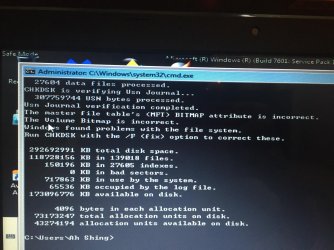

So I launch safe mode. And I use Chkdsk to try fix up the problem but still cannot. It stated that
" The Master file table's (MFT) BITMAP attribute is incorrect. "
" The Volume BITMAP is incorrect "

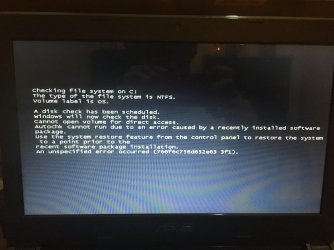

After that I use chkdsk /f to give it a try. But nothing was solve instead give me a error message
"Autochk cannot run due to an error caused by a recently installed software package.An unspecified error occurred (766f6c756d652e63 3f1) "
I didn't install any software recently. And now I completely stuck.
I suspect that was some error/corrupt in MBR
