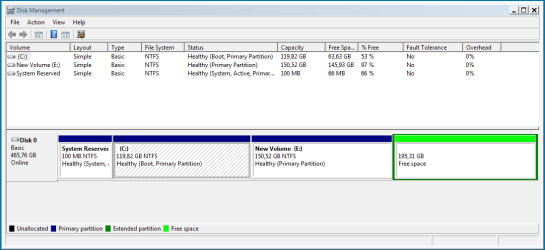

Please can you post a shot of your maximised disk management window
Start>diskmgmt.msc>enter

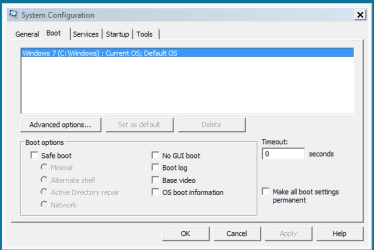

Also check the boot tab in msconfig for any entries

there is screenshot.
