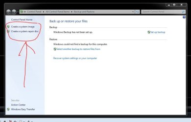

Forgot to mention you can make a system/startup repair disc from your PC, you need a blank CD and a CD burner.
