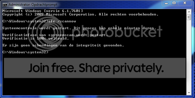

oke yeah i tried to use the windbg system but was to complicated for me, unless you have a threat for dummies :P
i can try to make a windbg file for you, ill try to remove MCafee and will use windows Defender as my main scanner and come back in a week

well its now a week later, and my crashes reduced alot, but now since i play WoW i get them again the last 2 days i crash in mid game.
i have tried what you suggested with the WinDBG and tried analyzing 1 crash
he gives this:

These crashes appear to point to hardware problems since they are blaming system files. Could also be system file corruption, a bad BIOS version, or drivers. Bug Check 0xA: IRQL_NOT_LESS_OR_EQUAL
Start by checking your Windows files.

i did the first scan and it says that there is nothing found (in dutch)
but after the crashes i saw that windows had to be updated so i installed the latest versions
so yesterday i played WoW without any problems and crashes (after the updates), i don't over-clock any hardware because i still feel that the system is unstable imo. (the crashes)
