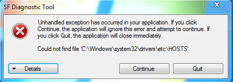

I received this error after running the Diagnostic Tool again.
